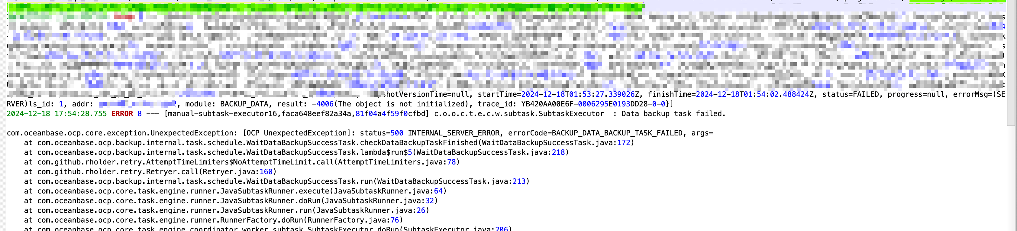

OCP 页面操作集群启动备份,备份命令下发正常,但是备份启动一段时间之后出现 -4006 异常。
同时日志伴随出现如下异常。
[2024-12-18 09:54:02.473073] WDIAG [COMMON] limit_and_sleep (utility.cpp:1409) [2024492][T1006_BACKUP_ME][T1006][xxxxx-xxxxx-xxxxx-xxxxx] [lt=37][errcode=-4006] throttle is not initialized.(ret=-4006)
[2024-12-18 09:54:02.473082] WDIAG [COMMON] limit_out_and_sleep (utility.cpp:1570) [2024492][T1006_BACKUP_ME][T1006][xxxxx-xxxxx-xxxxx-xxxxx] [lt=8][errcode=-4006] failed to limit out_throttle_(ret=-4006)
[2024-12-18 09:54:02.473088] WDIAG [STORAGE] flush_buffer_ (ob_backup_file_writer_ctx.cpp:140) [2024492][T1006_BACKUP_ME][T1006][xxxxx-xxxxx-xxxxx-xxxxx] [lt=5][errcode=-4006] failed to limit out and sleep(ret=-4006)
