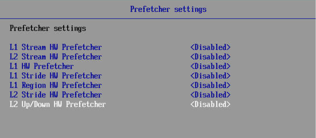

>DF Common Options>DF C-state Control>Disabled。BIOS 中关闭预取(CPU Prefetcher): Prefetcher settings
>L1 * HW Prefetcher/L2 * HW Prefetcher > Disabled。

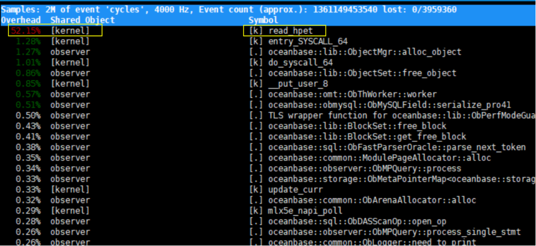

如果压测时发现系统硬件时钟源出现了从 tsc 跳变为 hpet 的情况,可以再额外配置下:
- 增加内核参数 "clocksource=tsc tsc=reliable tsc=nowatchdog"
==># grubby --update-kernel=ALL --args="clocksource=tsc tsc=reliable tsc=nowatchdog"。

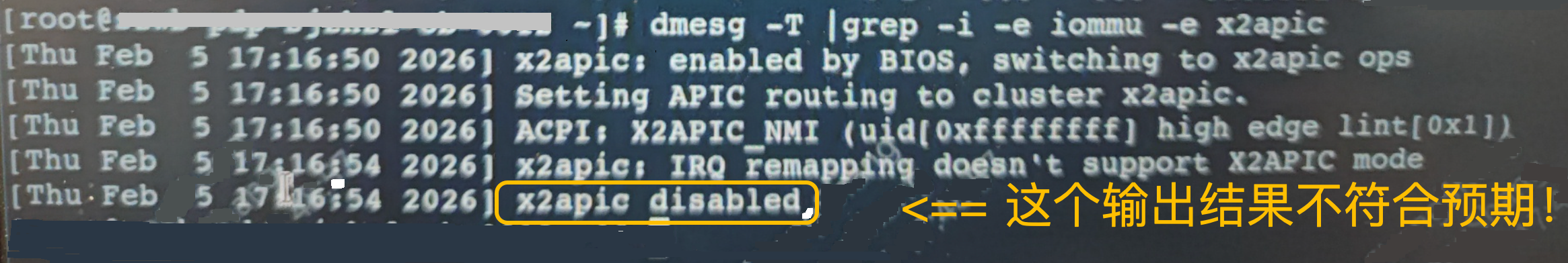

[root@ob85 ~]# dmesg -T | grep -i -e iommu -e x2apic
[Sun Oct 26 14:22:03 2025] x2apic: enabled by BIOS, switching to x2apic ops
[Sun Oct 26 14:22:03 2025] Setting APIC routing to cluster x2apic.
[Sun Oct 26 14:22:03 2025] ACPI: X2APIC_NMI (uid[0xffffffff] high edge lint[0x1])
[Sun Oct 26 14:22:03 2025] x2apic: IRQ remapping doesn't support X2APIC mode
[Sun Oct 26 14:22:03 2025] x2apic disabled
上述示例中出现 x2apic disabled,则说明没有正常启用 x2apic,需要启动 x2apic。

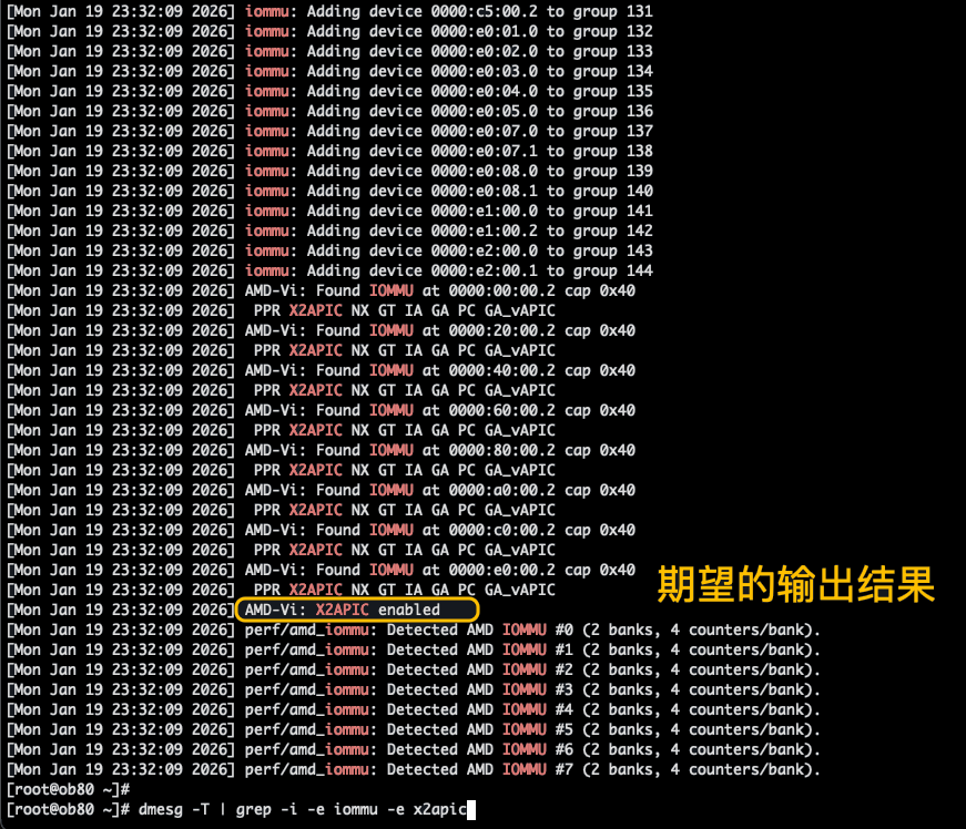

海光 7490 服务器上正常启用 x2apic 后的输出如下结果:
[Mon Jan 19 23:31:58 2026] x2apic: enabled by BIOS, switching to x2apic ops
[Mon Jan 19 23:31:58 2026] Setting APIC routing to cluster x2apic.
[Mon Jan 19 23:31:58 2026] ACPI: X2APIC_NMI (uid[0xffffffff] high level lint[0x1])
[Mon Jan 19 23:32:09 2026] AMD-Vi: IOMMU performance counters supported
[Mon Jan 19 23:32:09 2026] iommu: Adding device 0000:00:01.0 to group 0
[Mon Jan 19 23:32:09 2026] iommu: Adding device 0000:00:01.7 to group 1
[Mon Jan 19 23:32:09 2026] iommu: Adding device 0000:00:02.0 to group 2
[Mon Jan 19 23:32:09 2026] iommu: Adding device 0000:00:03.0 to group 3
[Mon Jan 19 23:32:09 2026] iommu: Adding device 0000:e1:00.0 to group 141
[Mon Jan 19 23:32:09 2026] iommu: Adding device 0000:e1:00.2 to group 142
[Mon Jan 19 23:32:09 2026] iommu: Adding device 0000:e2:00.0 to group 143
[Mon Jan 19 23:32:09 2026] iommu: Adding device 0000:e2:00.1 to group 144
[Mon Jan 19 23:32:09 2026] AMD-Vi: Found IOMMU at 0000:00:00.2 cap 0x40
[Mon Jan 19 23:32:09 2026] PPR X2APIC NX GT IA GA PC GA_vAPIC
[Mon Jan 19 23:32:09 2026] AMD-Vi: Found IOMMU at 0000:20:00.2 cap 0x40
[Mon Jan 19 23:32:09 2026] AMD-Vi: Found IOMMU at 0000:40:00.2 cap 0x40
[Mon Jan 19 23:32:09 2026] AMD-Vi: Found IOMMU at 0000:60:00.2 cap 0x40
[Mon Jan 19 23:32:09 2026] AMD-Vi: Found IOMMU at 0000:80:00.2 cap 0x40
[Mon Jan 19 23:32:09 2026] AMD-Vi: Found IOMMU at 0000:a0:00.2 cap 0x40
[Mon Jan 19 23:32:09 2026] AMD-Vi: Found IOMMU at 0000:c0:00.2 cap 0x40
[Mon Jan 19 23:32:09 2026] AMD-Vi: Found IOMMU at 0000:e0:00.2 cap 0x40
[Mon Jan 19 23:32:09 2026] AMD-Vi: X2APIC enabled
[Mon Jan 19 23:32:09 2026] perf/amd_iommu: Detected AMD IOMMU #0 (2 banks, 4 counters/bank).
[Mon Jan 19 23:32:09 2026] perf/amd_iommu: Detected AMD IOMMU #1 (2 banks, 4 counters/bank).
[Mon Jan 19 23:32:09 2026] perf/amd_iommu: Detected AMD IOMMU #2 (2 banks, 4 counters/bank).
[Mon Jan 19 23:32:09 2026] perf/amd_iommu: Detected AMD IOMMU #3 (2 banks, 4 counters/bank).
[Mon Jan 19 23:32:09 2026] perf/amd_iommu: Detected AMD IOMMU #4 (2 banks, 4 counters/bank).
[Mon Jan 19 23:32:09 2026] perf/amd_iommu: Detected AMD IOMMU #5 (2 banks, 4 counters/bank).
[Mon Jan 19 23:32:09 2026] perf/amd_iommu: Detected AMD IOMMU #6 (2 banks, 4 counters/bank).
[Mon Jan 19 23:32:09 2026] perf/amd_iommu: Detected AMD IOMMU #7 (2 banks, 4 counters/bank).

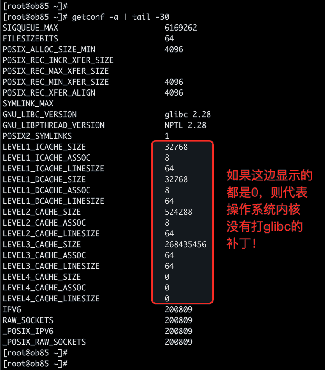

检查 glibc 的补丁是否已经被成功 patch
[root@ob85 ~]# getconf -a | tail -30
SIGQUEUE_MAX 6169262
FILESIZEBITS 64
POSIX_ALLOC_SIZE_MIN 4096
POSIX_REC_INCR_XFER_SIZE
POSIX_REC_MAX_XFER_SIZE
POSIX_REC_MIN_XFER_SIZE 4096
POSIX_REC_XFER_ALIGN 4096
SYMLINK_MAX
GNU_LIBC_VERSION glibc 2.28
GNU_LIBPTHREAD_VERSION NPTL 2.28
POSIX2_SYMLINKS 1
LEVEL1_ICACHE_SIZE 32768
LEVEL1_ICACHE_ASSOC 8
LEVEL1_ICACHE_LINESIZE 64
LEVEL1_DCACHE_SIZE 32768
LEVEL1_DCACHE_ASSOC 8
LEVEL1_DCACHE_LINESIZE 64
LEVEL2_CACHE_SIZE 524288
LEVEL2_CACHE_ASSOC 8
LEVEL2_CACHE_LINESIZE 64
LEVEL3_CACHE_SIZE 268435456
LEVEL3_CACHE_ASSOC 64
LEVEL3_CACHE_LINESIZE 64
LEVEL4_CACHE_SIZE 0
LEVEL4_CACHE_ASSOC 0
LEVEL4_CACHE_LINESIZE 0
IPV6 200809
RAW_SOCKETS 200809
_POSIX_IPV6 200809
_POSIX_RAW_SOCKETS 200809

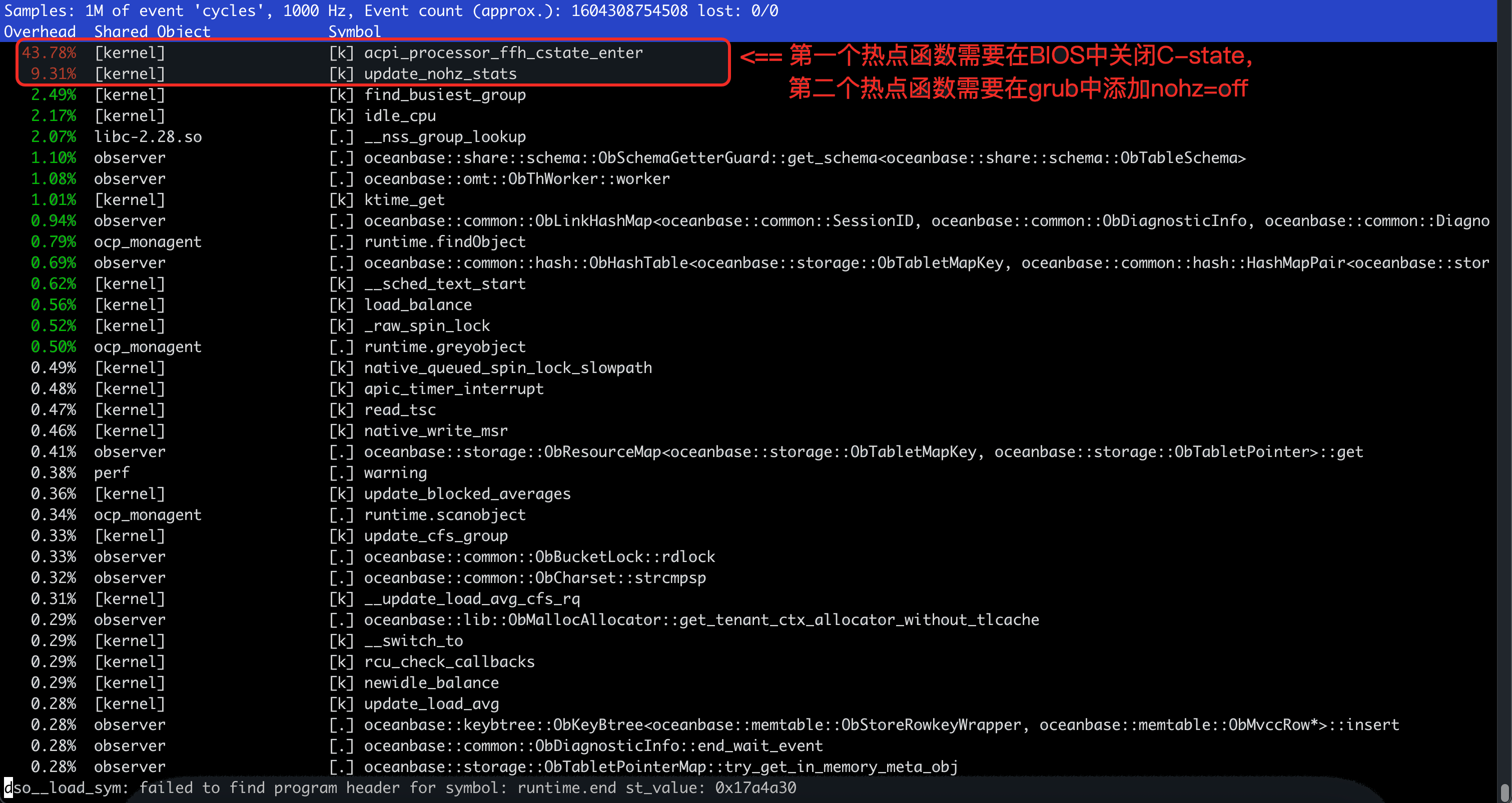

检查 perf top 结果
在整机空载或者数据库压测的情况下,不应该出现下面红框中的热点函数:
在整机空载或者数据库压测的情况下,不应该出现下面黄框中的热点函数,如果出现该热点函数,说明当前系统硬件时钟源已经从tsc跳变为hpet了,会导致整机性能严重受损:
