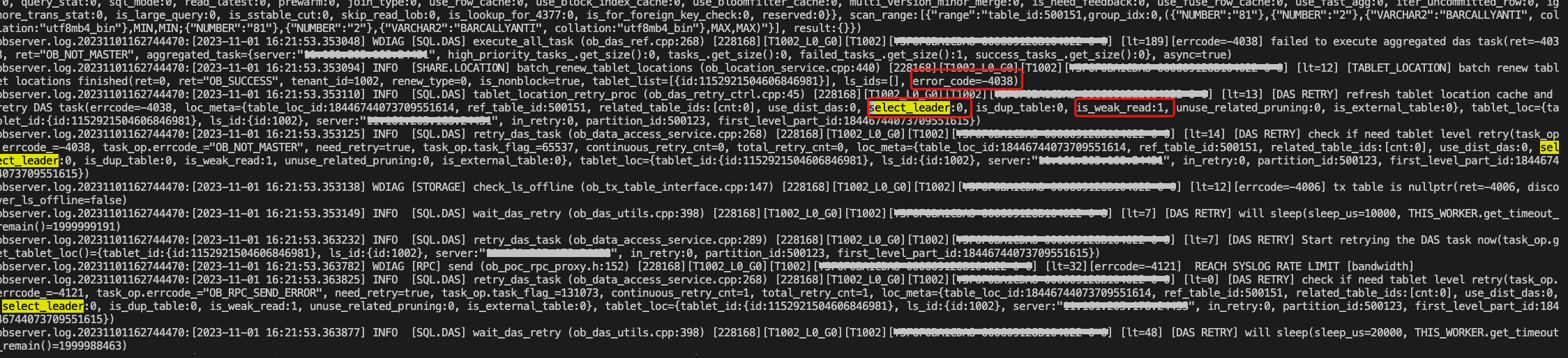

is_weak_read = 1,但实际上是强读场景,说明代码中读一致性不符合预期。[2023-11-22 11:38:22.537730] INFO [SQL.DAS] retry_das_task (ob_data_access_service.cpp:268) [28892][T1002_L0_G0][T1002][xxxxx-xxxxx-xxxxx-xxxxx] [lt=0] [DAS RETRY] check if need tablet level retry(task_op.errcode_=-6231, task_op.errcode_="OB_REPLICA_NOT_READABLE", need_retry=true, task_op.task_flag_=196609, continuous_retry_cnt=8, total_retry_cnt=8, loc_meta={table_loc_id:18446744073709551614, ref_table_id:500214, related_table_ids:[cnt:1, 500006], use_dist_das:0, select_leader:0, is_dup_table:0, is_weak_read:1, unuse_related_pruning:0, is_external_table:0}, tablet_loc={tablet_id:{id:1152921504606847334}, ls_id:{id:1003}, server:"xxx.xxx.xxx.xxx:xxxxx", in_retry:0, partition_id:500778, first_level_part_id:18446744073709551615})内部表中指明了是弱读、读版本号的问题。

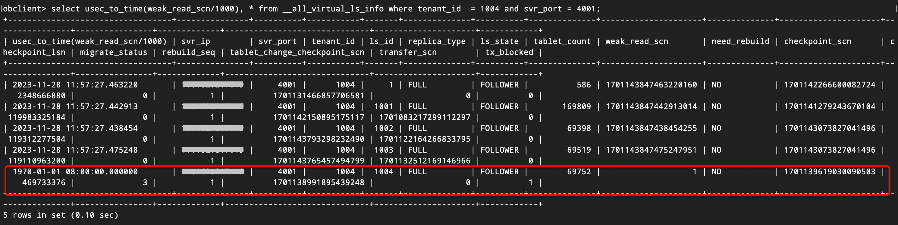

__all_virtual_ls_info内部表,可以看到日志流基础信息、当前状态、弱读时间戳等。obclient> select * from oceanbase.__all_virtual_ls_info;输出结果如下:
+------------+----------+-----------+-------+--------------+----------+--------------+---------------------+--------------+---------------------+----------------+----------------+-------------+------------------------------+--------------+------------+ | svr_ip | svr_port | tenant_id | ls_id | replica_type | ls_state | tablet_count | weak_read_scn | need_rebuild | checkpoint_scn | checkpoint_lsn | migrate_status | rebuild_seq | tablet_change_checkpoint_scn | transfer_scn | tx_blocked | +------------+----------+-----------+-------+--------------+----------+--------------+---------------------+--------------+---------------------+----------------+----------------+-------------+------------------------------+--------------+------------+ | 11.xxx.x.x | 23401 | 1 | 1 | FULL | LEADER | 883 | 1701759448288138594 | NO | 1701746333707807782 | 20265639936 | 0 | 0 | 1701744491477219992 | 0 | 0 | | 11.xxx.x.x | 23401 | 1001 | 1 | FULL | LEADER | 813 | 1701759448517986005 | NO | 1701712914332492073 | 67104768 | 0 | 0 | 1701688082212114135 | 0 | 0 | | 11.xxx.x.x | 23401 | 1002 | 1 | FULL | LEADER | 586 | 1701759448814797204 | NO | 1701712806815054654 | 0 | 0 | 0 | 1701688096813947256 | 0 | 0 |分析日志。

如果
migrate_status或者tx_blocked非 0,那么日志流就是处于迁移或者锁定状态,这时候不可读是正常的。如果日志流状态没有问题,那么可能是弱读时间戳的问题。将
weak_read_scn与当前时间进行对比,就可以知道弱读时间戳落后了多少。再结合ob_max_read_stale_time与错误发生的时间(日志打印时间,或相关表记录的创建时间),就可以判断日志流的时间戳是否可读。进行弱读时间戳转换。

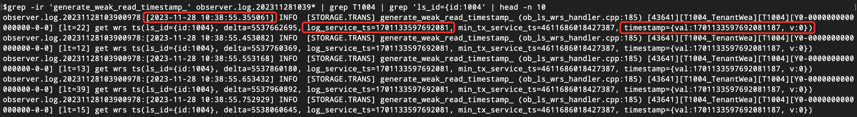

通过分析上述信息,问题是合并卡住,原因是 weak read ts is not ready, compaction_scn=1701136214973179751 。将 compaction_scn 的值 1701136214973179751 转换一下是 2023-11-28 09:50:14.973180,明显早于合并任务的创建时间 2023-11-28 10:39:38.700144。问题的核心就在于弱读时间戳过于落后,搜索 generate_weak_read_timestamp_ 找到生成弱读时间戳的日志,可以看到时间戳是来源于 log_service_ts。

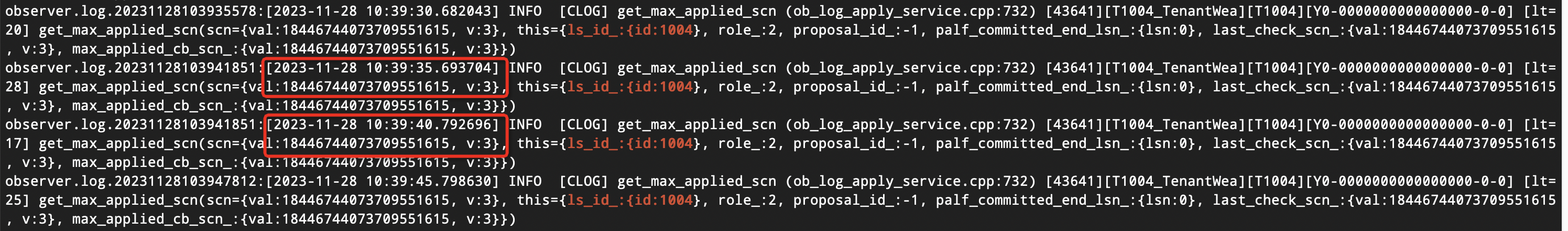

在代码中跟踪其来源,log_service_ts 的值来自于 max_applied_scn 和 max_replayed_scn 的最大值,而日志显示 max_applied_scn 是不可用的(v=3,而且数字明显很大),因此 max_replayed_scn 就是弱读时间戳的最终来源,如下所示。
} else {
scn = std::max(max_replayed_scn, max_applied_scn) > SCN::min_scn() ?
std::max(max_replayed_scn, max_applied_scn) : SCN::min_scn();
CLOG_LOG(TRACE, "get_max_decided_scn", K(ret), K(id), K(max_replayed_scn), K(max_applied_scn), K(scn));

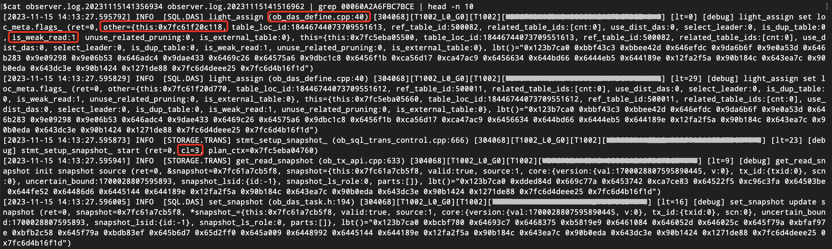

当存在读一致性类型不符合预期的情况时,一般可在日志中看到类似 is_weak_read:0 的内容,或者通过日志判断代码走到了属于弱读的流程中。无论是通过查看日志还是分析代码,应该是能够知道出问题的代码位置的。如果要继续分析,需要对弱读类型的判断机制有一定了解。 基于代码中这个类似 is_weak_read = true 的标记,追踪它是在哪里设置为 true 的,然后继续分析相关代码的逻辑。这时候如果出现了很多分支无法确定代码路径,可能需要增加日志复现或者联系 OceanBase 技术支持人员提供相应的协助。
案例:备库SQL执行过程中语句 consistency_level 不一致
问题描述
强读场景(当前只关注弱读类型的问题),日志中出现 is_weak_read:1 信息,读类型不符合预期。

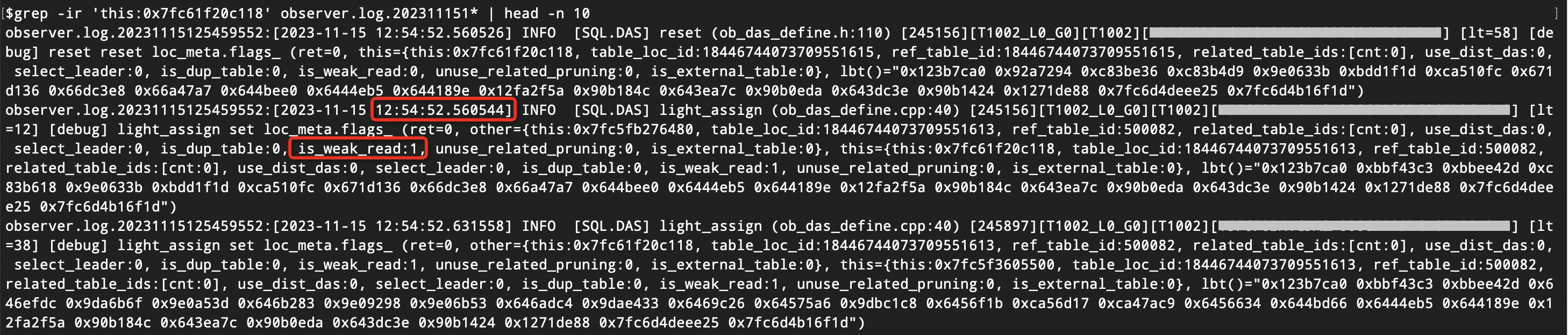

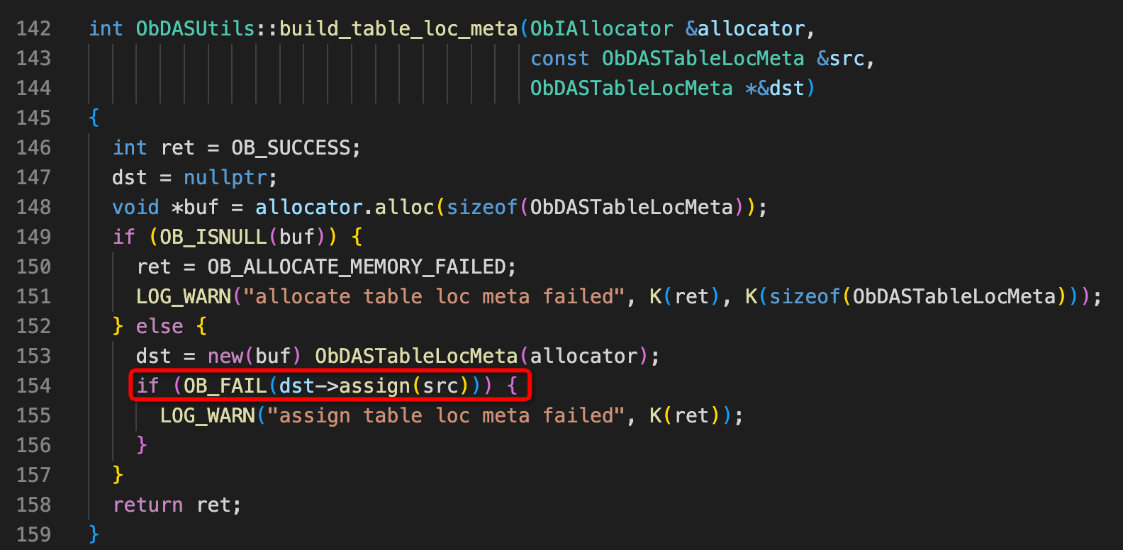

通过分析上述信息,这个错误的弱读类型是从 loc_meta 打印出来的。在常规路径下,判断读类型都会调用 get_is_weak_read 函数,而通过 trace id 搜索到的日志没有发现对 get_is_weak_read 的调用,说明其中的 flag_ 是在其他地方设置的。增加日志复现分析,首先可以确定从 SQL 层开始这是一个强读请求(cl=3)。
通过打印调用栈可以发现,更新 loc_meta.flag_ 的地方位于 build_table_loc_meta 函数中,而其中的 src 结构早在一个小时前就创建了。
这是根据地址 0x7fc61f20c118 搜索这个 loc_meta 结构最初的来源,在时间点 12:54:52 就已经存在了,而报错日志的时间是 14:13:27。
用过时 loc_meta 的 flag 去覆盖当前请求的 loc_meta。

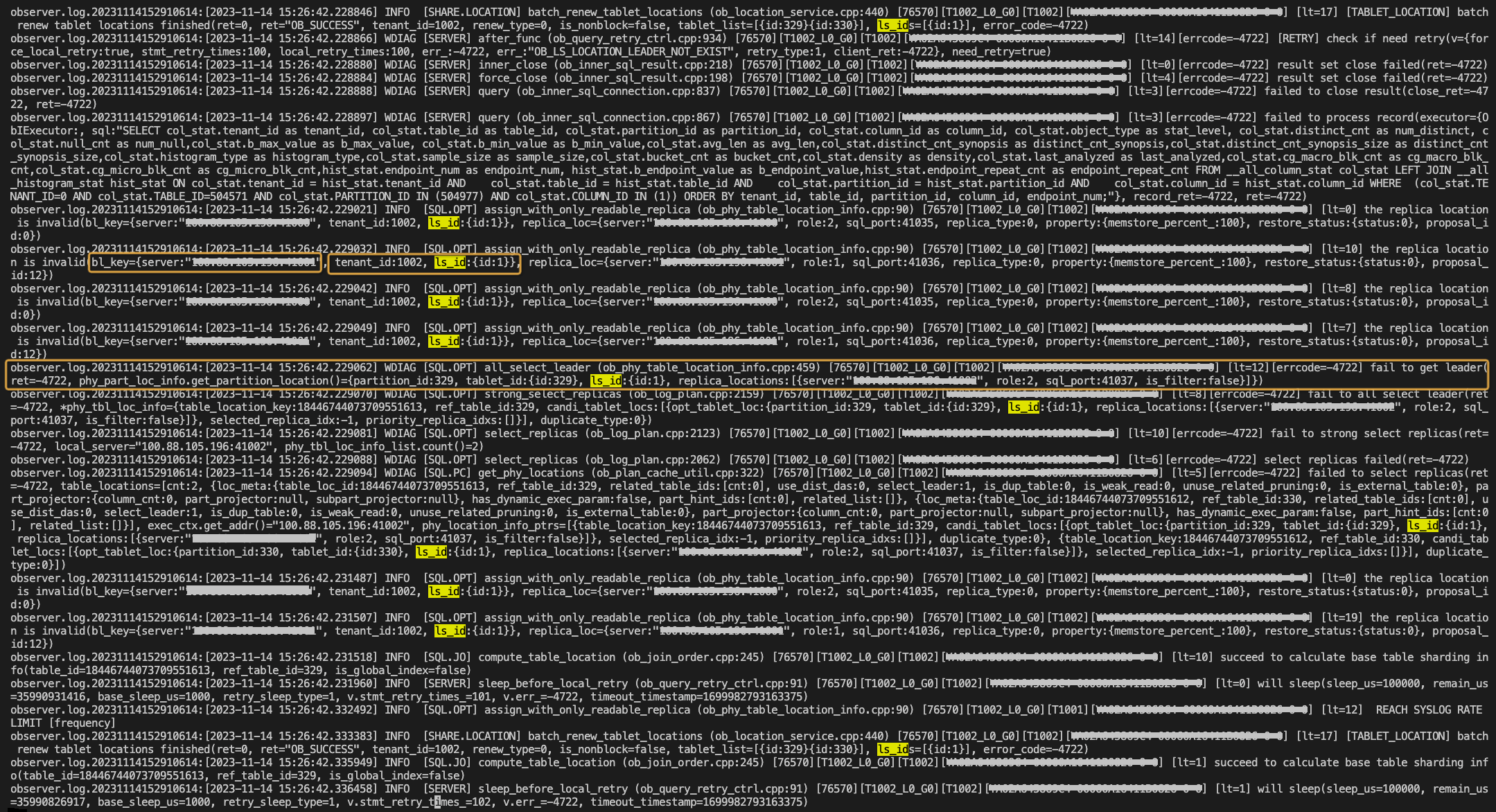

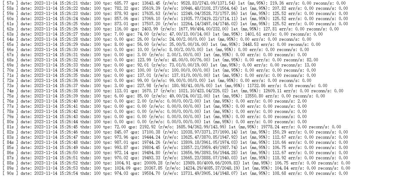

RTO 回退严重,超过 15s 甚至 20s。杀掉一个节点后,TPS 存在十多秒的跌零的问题。

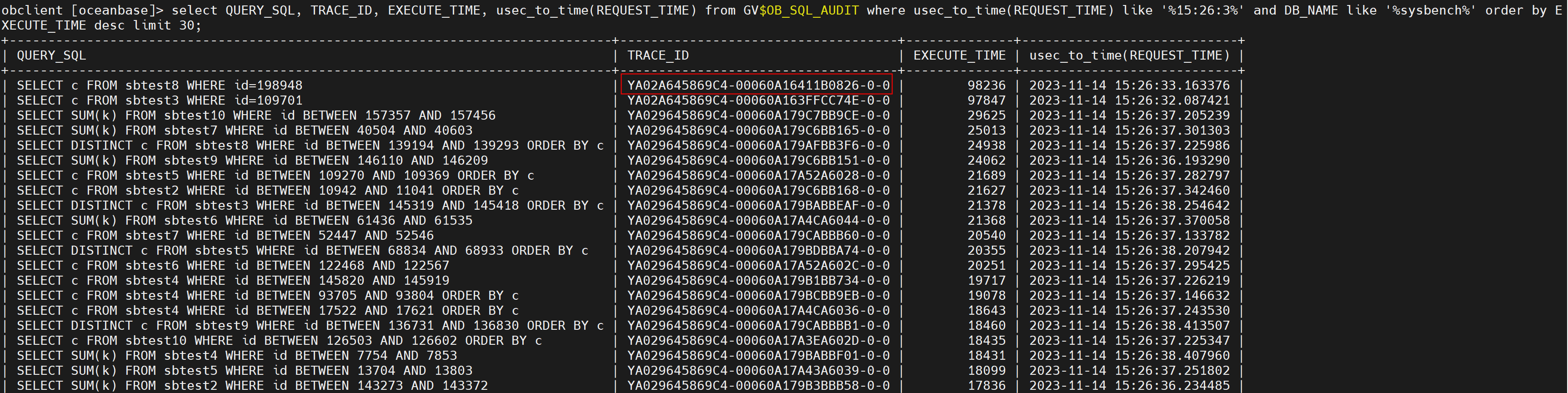

查询超时,如下语句。
select QUERY_SQL, TRACE_ID, EXECUTE_TIME, usec_to_time(REQUEST_TIME) from GV$OB_SQL_AUDIT where usec_to_time(REQUEST_TIME) like '%15:26:3%' and DB_NAME like '%sysbench%' order by EXECUTE_TIME desc limit 30;

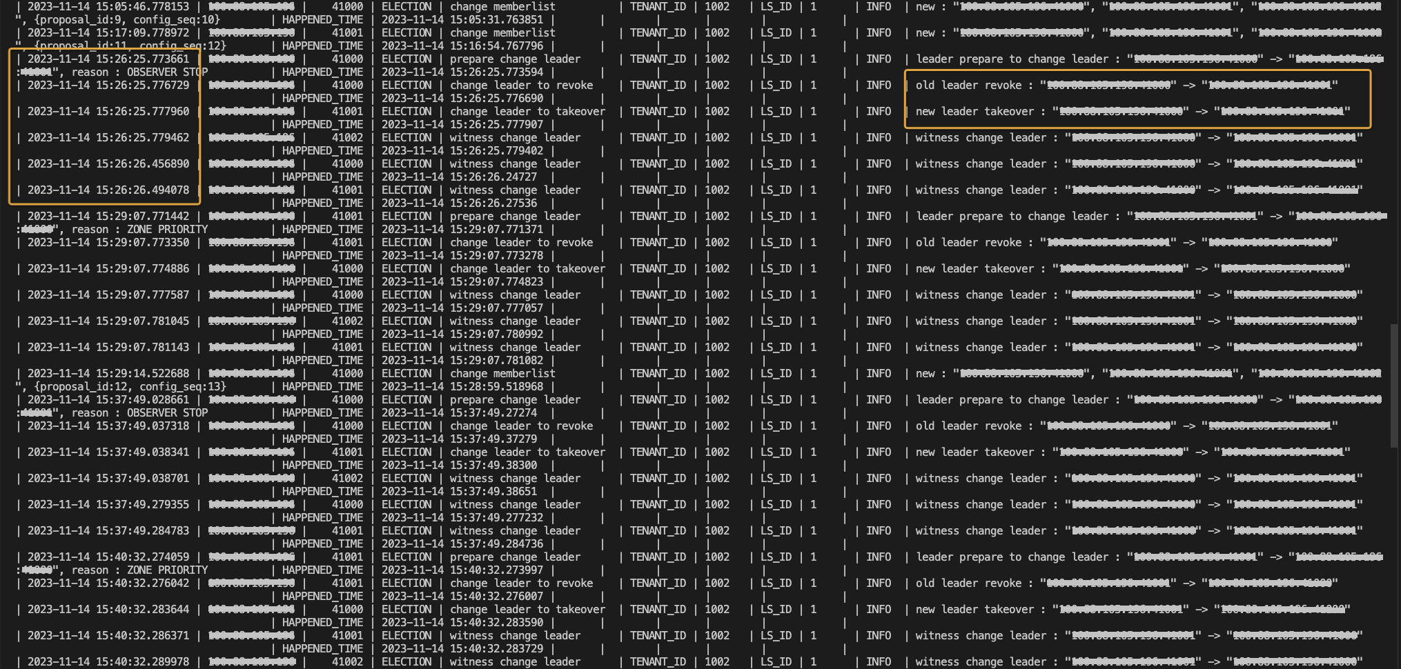

通过分析上述信息,首先查看 leader 状态,可以看到时间点 2023-11-14 15:26:26,leader 已经在 z2 上任,但之后依然有十几秒 TPS 跌零(见问题描述),可见选举没有问题。
查看日志搜索 WDIAG,发现很多 -4722 错误码,源头来自 all_select_leader 函数中的报错 fail to get leader,意思是没有获取到 leader 副本。进一步分析发现,assign_with_only_readable_replica 函数打印的日志,日志流类型为 leader(role=2),但是却被判断为不可用,这显然是不合逻辑的。
分析代码发现,该日志流在黑名单中,因而判断它不可读。但是当前时刻该日志流已经成为了 leader,由此推测黑名单是不准确的。

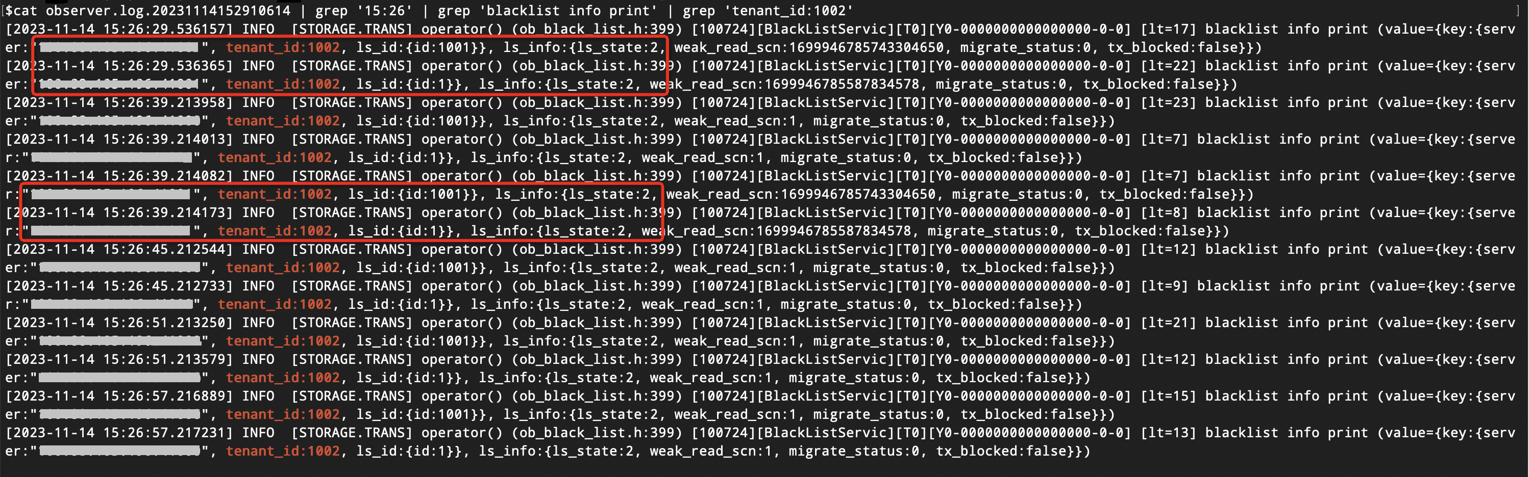

搜索黑名单日志,可以看到日志流的状态是 follower,因为主库的 leader 是不可能被加入黑名单的。那说明该日志流之前是 follower,成为 leader 之后黑名单没能及时刷新,从而导致了误判。
日志流黑名单默认是 3s 刷新一次,刷新的方式是查询内部表。通过日志可以看到,查内部表的 SQL 超时(10s),导致更新失败,而查询失败 3 次才会清空黑名单,因而导致黑名单出现十多秒的延迟。这条内部 SQL 中的 hint 实际上不会生效,需要调用专门的接口设置超时时间才行,这里就是导致黑名单长时间未更新的关键原因。
observer.log.20231122112615034:[2023-11-22 11:24:48.311055] WDIAG [STORAGE.TRANS] do_thread_task_ (ob_black_list.cpp:204) [16268][BlackListServic][T0][Y0-0000000000000000-0-0] [lt=7][errcode=-4012] fail to execute sql(ret=-4012, ret="OB_TIMEOUT", sql=select /*+query_timeout(2000000)*/ a.svr_ip, a.svr_port, a.tenant_id, a.ls_id, a.role, nvl(b.weak_read_scn, 1) as weak_read_scn, nvl(b.migrate_status, 0) as migrate_status, nvl(b.tx_blocked, 0) as tx_blocked from oceanbase.__all_virtual_ls_meta_table a left join oceanbase.__all_virtual_ls_info b on a.svr_ip = b.svr_ip and a.svr_port = b.svr_port and a.tenant_id = b.tenant_id and a.ls_id = b.ls_id;)
然而就算解决了 SQL 超时的问题,黑名单仍然存在 3s 的延迟,所以需要兜底机制。
综上信息分析可知切主过程中,黑名单访问内部表超时,没有及时更新,导致 leader 副本无法被访问,进而导致 TPS 长时间跌零的问题。
