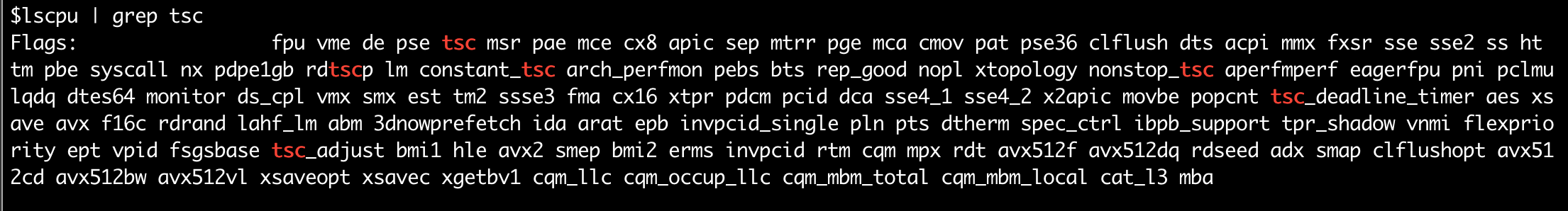

检查 CPU 型号。
# 命令是否存在结果 lscpu | grep tsc输出结果如下:
如果有结果,再进行下文的检查。但是经过实践发现,鲲鹏等 ARM 的 CPU 下,

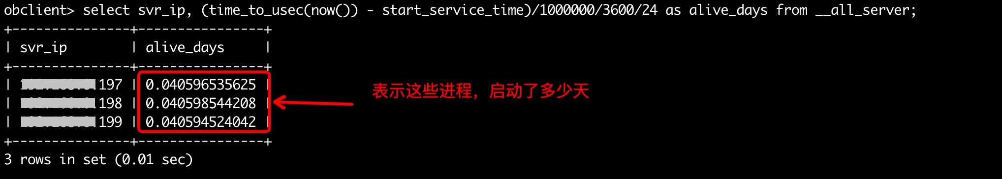

lscpu的flag结果并没有,但问题依然是存在的。所以需要本文档 巡检方式 这一节内容来进一步的判断。查询内部表,确认目前是否已经出现问题,或者还有多少天会出现问题。
select svr_ip, (time_to_usec(now()) - start_service_time)/1000000/3600/24 as alive_days from __all_server;输出结果如下:
对于 2.5GH 的 CPU,203 天就已经出现了问题。

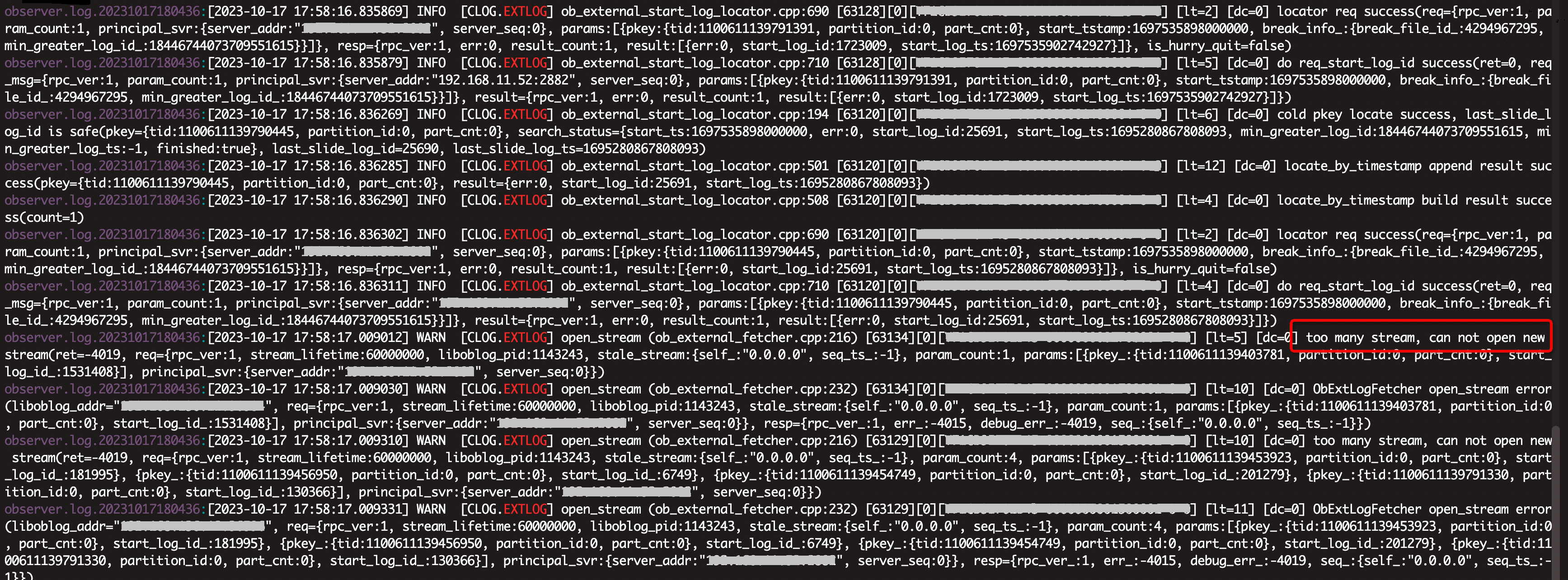

使用命令过滤 liboblog/libobcdc 报错日志。
grep open_stream_ liboblog.log* | grep 4015
输出结果如下:
liboblog.log:[2023-10-17 17:58:17.009182] EDIAG [TLOG.FETCHER] open_stream_ (ob_log_fetch_stream.cpp:439) [1143718][0][Y71CB9E701D45-0000000001700001-0-0] [lt=11][errcode=0] open stream fail on server(svr_identity={principal_svr:{server_addr:"xxx.xxx.xxx.xxx:xxx", server_seq:0}, request_svr:"xxx.xxx.xxx.xxx:xxx"}, svr_err=-4015, svr_debug_err=-4019, rcode={code:0, msg:"", warnings:[]}, req={rpc_ver:1, stream_lifetime:60000000, liboblog_pid:1143243, stale_stream:{self_:"0.0.0.0", seq_ts_:-1}, param_count:1, params:[{pkey_:{tid:1100611139403781, partition_id:0, part_cnt:0}, start_log_id_:1531408}], principal_svr:{server_addr:"xxx.xxx.xxx.xxx:xxx", server_seq:0}}, resp={rpc_ver_:1, err_:-4015, debug_err_:-4019, seq_:{self_:"0.0.0.0", seq_ts_:-1}}) BACKTRACE:0x16017b90 0x15ff5577 0xa3f0edc 0xa47d7c2 0xa3c8950 0xa3c7644 0xa3c4db7 0xa3c4b2d 0xa8369dc 0xa8a3162 0xa95a3df 0x7f30eea8dea5 0x7f30ee0a78dd
liboblog.log:[2023-10-17 17:58:17.009743] EDIAG [TLOG.FETCHER] open_stream_ (ob_log_fetch_stream.cpp:439) [1143717][0][Y71CB9E701D45-0000000001500001-0-0] [lt=22][errcode=0] open stream fail on server(svr_identity={principal_svr:{server_addr:"xxx.xxx.xxx.xxx:xxx", server_seq:0}, request_svr:"xxx.xxx.xxx.xxx:xxx"}, svr_err=-4015, svr_debug_err=-4019, rcode={code:0, msg:"", warnings:[]}, req={rpc_ver:1, stream_lifetime:60000000, liboblog_pid:1143243, stale_stream:{self_:"0.0.0.0", seq_ts_:-1}, param_count:4, params:[{pkey_:{tid:1100611139453923, partition_id:0, part_cnt:0}, start_log_id_:181995}, {pkey_:{tid:1100611139456950, partition_id:0, part_cnt:0}, start_log_id_:6749}, {pkey_:{tid:1100611139454749, partition_id:0, part_cnt:0}, start_log_id_:201279}, {pkey_:{tid:1100611139791330, partition_id:0, part_cnt:0}, start_log_id_:130366}], principal_svr:{server_addr:"xxx.xxx.xxx.xxx:xxx", server_seq:0}}, resp={rpc_ver_:1, err_:-4015, debug_err_:-4019, seq_:{self_:"0.0.0.0", seq_ts_:-1}}) BACKTRACE:0x16017b90 0x15ff5577 0xa3f0edc 0xa47d7c2 0xa3c8950 0xa3c7644 0xa3c4db7 0xa3c4b2d 0xa8369dc 0xa8a3162 0xa95a3df 0x7f30eea8dea5 0x7f30ee0a78dd
liboblog.log.20231012160726018:[2023-10-12 11:04:06.718034] EDIAG [TLOG.FETCHER] open_stream_ (ob_log_fetch_stream.cpp:437) [1227713][0][YBA359E701D45-0000000000C00001-0-0] [lt=26][errcode=0] open stream fail on server(svr_identity={principal_svr:{server_addr:"xxx.xxx.xxx.xxx:xxx", server_seq:0}, request_svr:"xxx.xxx.xxx.xxx:xxx"}, svr_err=-4015, svr_debug_err=-4019, rcode={code:0, msg:"", warnings:[]}, req={rpc_ver:1, stream_lifetime:60000000, liboblog_pid:1227317, stale_stream:{self_:"0.0.0.0", seq_ts_:-1}, param_count:2, params:[{pkey_:{tid:1100611139453923, partition_id:0, part_cnt:0}, start_log_id_:178514}, {pkey_:{tid:1100611139456950, partition_id:0, part_cnt:0}, start_log_id_:6627}], principal_svr:{server_addr:"xxx.xxx.xxx.xxx:xxx", server_seq:0}}, resp={rpc_ver_:1, err_:-4015, debug_err_:-4019, seq_:{self_:"0.0.0.0", seq_ts_:-1}}) BACKTRACE:0x7fb09687b53b 0x7fb096863287 0x7fb08aea9c0c 0x7fb08af36212 0x7fb08ae7be26 0x7fb08ae7a9a4 0x7fb08ae78097 0x7fb08ae77e0d 0x7fb08b2f009c 0x7fb08b35b1fe 0x7fb08b405fdf 0x7fb0e7bb1ea5 0x7fb0e71cb8dd
liboblog.log.20231012160726018:[2023-10-12 11:04:06.723251] EDIAG [TLOG.FETCHER] open_stream_ (ob_log_fetch_stream.cpp:437) [1227715][0][YBA359E701D45-0000000000E00001-0-0] [lt=15][errcode=0] open stream fail on server(svr_identity={principal_svr:{server_addr:"xxx.xxx.xxx.xxx:xxx", server_seq:0}, request_svr:"xxx.xxx.xxx.xxx:xxx"}, svr_err=-4015, svr_debug_err=-4019, rcode={code:0, msg:"", warnings:[]}, req={rpc_ver:1, stream_lifetime:60000000, liboblog_pid:1227317, stale_stream:{self_:"0.0.0.0", seq_ts_:-1}, param_count:1, params:[{pkey_:{tid:1100611139403781, partition_id:0, part_cnt:0}, start_log_id_:1527938}], principal_svr:{server_addr:"xxx.xxx.xxx.xxx:xxx", server_seq:0}}, resp={rpc_ver_:1, err_:-4015, debug_err_:-4019, seq_:{self_:"0.0.0.0", seq_ts_:-1}}) BACKTRACE:0x7fb09687b53b 0x7fb096863287 0x7fb08aea9c0c 0x7fb08af36212 0x7fb08ae7be26 0x7fb08ae7a9a4 0x7fb08ae78097 0x7fb08ae77e0d 0x7fb08b2f009c 0x7fb08b35b1fe 0x7fb08b405fdf 0x7fb0e7bb1ea5 0x7fb0e71cb8dd
liboblog.log.20231012160726018:[2023-10-12 11:04:06.725130] EDIAG [TLOG.FETCHER] open_stream_ (ob_log_fetch_stream.cpp:437) [1227713][0][YBA359E701D45-0000000000C00002-0-0] [lt=9][errcode=0] open stream fail on server(svr_identity={principal_svr:{server_addr:"xxx.xxx.xxx.xxx:xxx", server_seq:0}, request_svr:"xxx.xxx.xxx.xxx:xxx"}, svr_err=-4015, svr_debug_err=-4019, rcode={code:0, msg:"", warnings:[]}, req={rpc_ver:1, stream_lifetime:60000000, liboblog_pid:1227317, stale_stream:{self_:"0.0.0.0", seq_ts_:-1}, param_count:2, params:[{pkey_:{tid:1100611139454749, partition_id:0, part_cnt:0}, start_log_id_:201279}, {pkey_:{tid:1100611139791330, partition_id:0, part_cnt:0}, start_log_id_:119190}], principal_svr:{server_addr:"xxx.xxx.xxx.xxx:xxx", server_seq:0}}, resp={rpc_ver_:1, err_:-4015, debug_err_:-4019, seq_:{self_:"0.0.0.0", seq_ts_:-1}}) BACKTRACE:0x7fb09687b53b 0x7fb096863287 0x7fb08aea9c0c 0x7fb08af36212 0x7fb08ae7be26 0x7fb08ae7a9a4 0x7fb08ae78097 0x7fb08ae77e0d 0x7fb08ae782c2 0x7fb08ae77e0d 0x7fb08b2f009c 0x7fb08b35b1fe 0x7fb08b405fdf 0x7fb0e7bb1ea5 0x7fb0e71cb8dd
