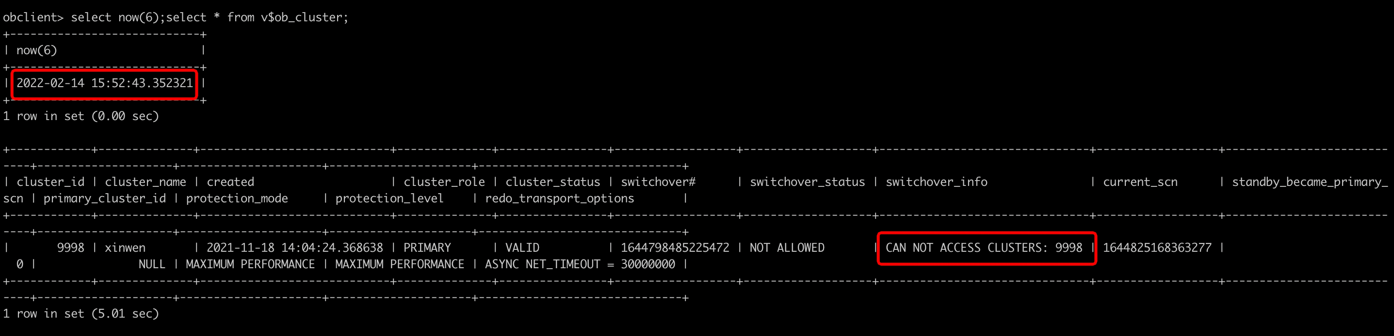

Switchover 状态信息。

obclient> select * from v$ob_cluster;
| cluster_id | cluster_name | created | cluster_role | cluster_status | switchover# | switchover_status | switchover_info | current_scn | standby_became_primary_scn | primary_cluster_id | protection_mode | protection_level | redo_transport_options |
| 9998 | obcluster | 2021-11-18 14:04:24.368638 | PRIMARY | VALID | 1644798485225472 | NOT ALLOWED | CAN NOT ACCESS CLUSTERS: 9998 | 1644825168363277 | 0 | NULL | MAXIMUM PERFORMANCE | MAXIMUM PERFORMANCE | ASYNC NET_TIMEOUT = 30000000 |
1 row in set (5.01 sec)
