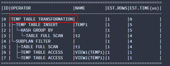

虽然优化器会对 CTE 抽取进行一些评估,但当前还是存在一些不足,主要集中在命中索引的情况。我们简单修改下上面的例子,首先创建一个 t2 上的索引,并将 SQL 中子查询里的过滤条件从一个常量值修改为相关表 t1 的参数。可以看到,现在优化器仍然生成了一个 TEMP TABLE,并没有利用上我们刚刚建立的索引。这会导致 t2 的全表扫描与聚合,性能低。

obclient> EXPLAIN SELECT (SELECT aggr FROM v WHERE c1 = t1.c1), (SELECT aggr FROM v WHERE c1=t1.c2) FROM t1;输出结果如下:
+----------------------------------------------------------------------------------------------------------+ | Query Plan | +----------------------------------------------------------------------------------------------------------+ | ================================================================= | | |ID|OPERATOR |NAME |EST.ROWS|EST.TIME(us)| | | ----------------------------------------------------------------- | | |0 |TEMP TABLE TRANSFORMATION| |1 |9 | | | |1 |├─TEMP TABLE INSERT |TEMP1 |1 |5 | | | |2 |│ └─HASH GROUP BY | |1 |5 | | | |3 |│ └─TABLE FULL SCAN |t2 |1 |4 | | | |4 |└─SUBPLAN FILTER | |1 |4 | | | |5 | ├─TABLE FULL SCAN |t1 |1 |4 | | | |6 | ├─TEMP TABLE ACCESS |VIEW1(TEMP1)|1 |1 | | | |7 | └─TEMP TABLE ACCESS |VIEW2(TEMP1)|1 |1 | | | ================================================================= | | Outputs & filters: | | ------------------------------------- | | 0 - output([subquery(1)], [subquery(2)]), filter(nil), rowset=16 | | 1 - output(nil), filter(nil), rowset=16 | | 2 - output([T_FUN_MAX(t2.c2)], [t2.c1]), filter(nil), rowset=16 | | group([t2.c1]), agg_func([T_FUN_MAX(t2.c2)]) | | 3 - output([t2.c1], [t2.c2]), filter(nil), rowset=16 | | access([t2.c1], [t2.c2]), partitions(p0) | | is_index_back=false, is_global_index=false, | | range_key([t2.__pk_increment]), range(MIN ; MAX)always true | | 4 - output([subquery(1)], [subquery(2)]), filter(nil), rowset=16 | | exec_params_([t1.c1(:0)], [t1.c2(:1)]), onetime_exprs_(nil), init_plan_idxs_(nil), use_batch=false | | 5 - output([t1.c1], [t1.c2]), filter(nil), rowset=16 | | access([t1.c1], [t1.c2]), partitions(p0) | | is_index_back=false, is_global_index=false, | | range_key([t1.__pk_increment]), range(MIN ; MAX)always true | | 6 - output([VIEW1.T_FUN_MAX(t2.c2)]), filter([VIEW1.t2.c1 = :0]), rowset=16 | | access([VIEW1.T_FUN_MAX(t2.c2)], [VIEW1.t2.c1]) | | 7 - output([VIEW2.T_FUN_MAX(t2.c2)]), filter([VIEW2.t2.c1 = :1]), rowset=16 | | access([VIEW2.T_FUN_MAX(t2.c2)], [VIEW2.t2.c1]) | +----------------------------------------------------------------------------------------------------------+ 32 rows in set (0.010 sec)

综上通过 EXPLAIN 查看执行计划, 0 号算子为 TEMP TABLE TRANSFORMATION,基本可以确定是 TEMP TABLE 抽取带来的问题。
