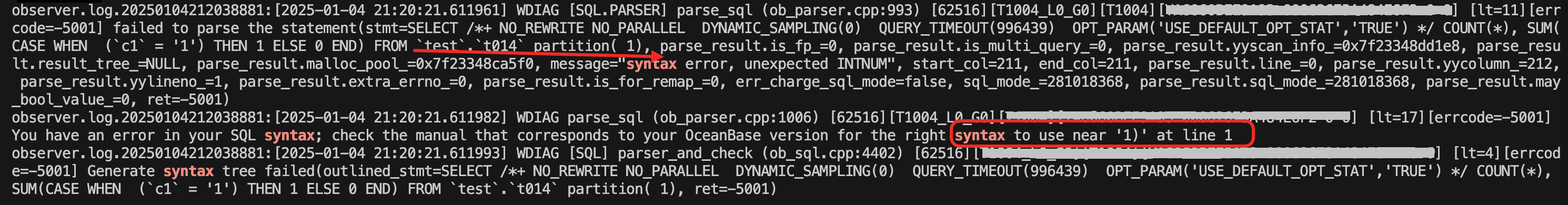

查询中通过添加动态采样 Hint,触发动态采样。对应日志报错如下。
[2025-01-04 21:20:21.611949] INFO [SQL.PARSER] parse_sql (ob_parser.cpp:952) [62516][T1004_L0_G0][T1004][xxxxx-xxxxx-xxxxx-xxxxx] [lt=5] fail
ed to parse stmt as sql(stmt=SELECT /*+ NO_REWRITE NO_PARALLEL DYNAMIC_SAMPLING(0) QUERY_TIMEOUT(996439) OPT_PARAM('USE_DEFAULT_OPT_STAT','TRUE') */ COUNT(*), SUM(CASE WHEN (`c1` =
'1') THEN 1 ELSE 0 END) FROM `test`.`t014` partition( 1), ret=-5001)
